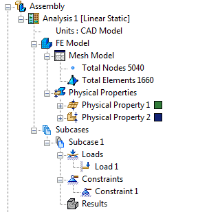

Subcases Sub-Levels
For Static, Linear Buckling, Prestress Static, Linear Steady State Heat Transfer and Nonlinear Steady State Heat Transfer analysis types:
Subcases behave differently between linear and nonlinear solution types. Linear solutions are analogous to completely new and different analyses. Nonlinear solutions use the end of the previous subcase as an initial condition for next subcase.

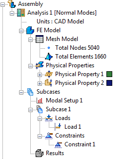

For Normal Modes analysis types:

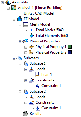

For Linear Buckling analysis types with two subcases by default:

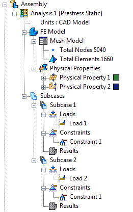

For Prestress Static analysis types with two subcases by default:

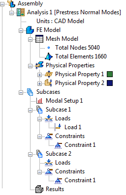

For Prestress Normal Modes analysis types with two subcases by default:

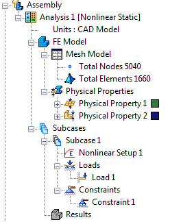

For Nonlinear Static analysis types:

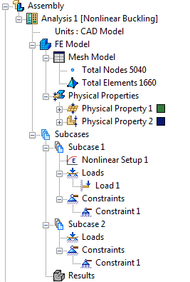

For Nonlinear Buckling analysis types with two subcases by default.

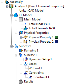

For Direct Transient Response analysis type:

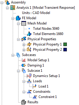

For Modal Transient Response analysis type:

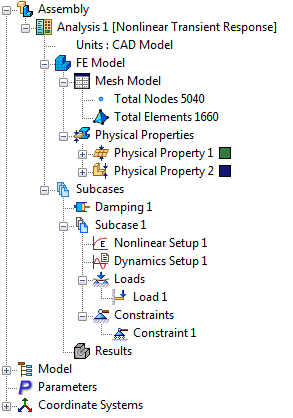

For Nonlinear Transient Response analysis type:

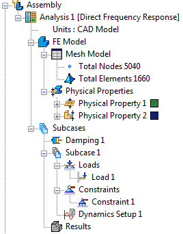

For Direct Frequency Response analysis type:

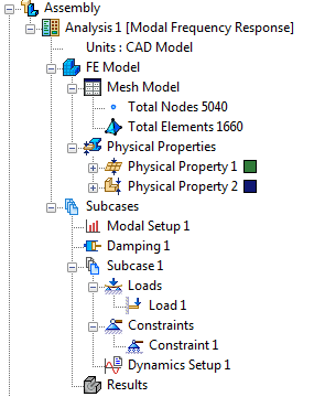

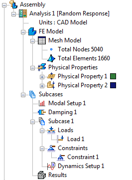

For Modal Frequency Response and Random Response analysis type:

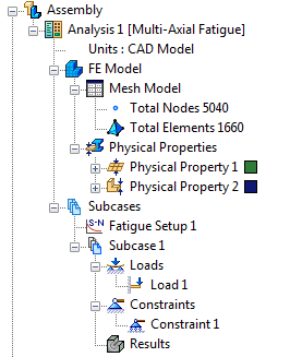

For Multi-Axial Fatigue analysis type:

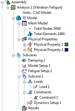

For Vibration Fatigue analysis type:

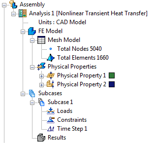

For Nonlinear Transient Heat Transfer analysis type:
