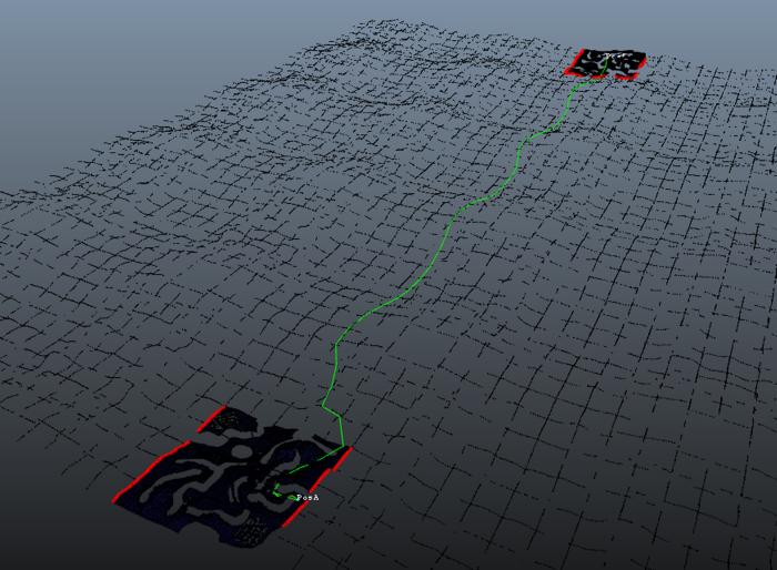

The following figure shows a path computed using AbstractGraphs with NavMeshes only at the start point and end point.

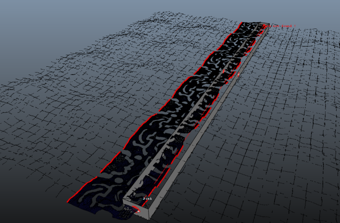

The following figure shows how a path is not found using only NavMeshes because of the box extent. If you increase the box extent, the path finding fails due to lack of working memory.
