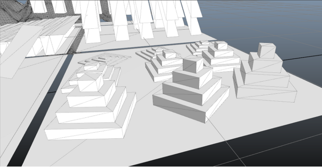

To visualize the difference between the default NavMesh and a vertically accurate NavMesh, take the following sample terrain.

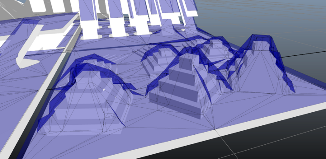

Assuming the movement model configured for the NavData generation system allows the character to traverse these pyramids freely, the following NavMesh is generated by default.
The NavMesh shown above accurately represents the navigability of the area, and can be used at runtime by your bots without problems. However, although the general shape of the terrain can be seen in the NavMesh, it does not reflect the altitude of the original terrain mesh very closely. If you were to use the altitude of this NavMesh to determine the altitude of your characters without using a collision system to clamp their feet to the actual ground altitude, your characters’ feet would alternately hover a little above the ground or a little below the pyramids. (Note that to avoid Z-fighting, the Navigation Lab offsets the altitude of the NavMesh a little from the altitude of the terrain for display purposes. The real altitude of the NavMesh crosses under the terrain mesh in places.)

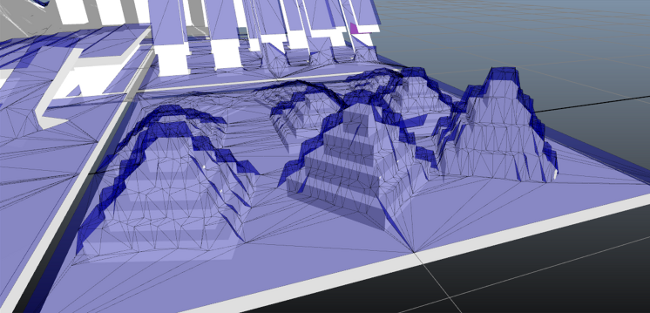

You can therefore decrease the vertical tolerance (and the horizontal sampling step) in order to increase the precision with which the NavMesh follows the terrain. If necessary, you can achieve a very high fidelity like in the following image:
