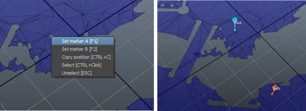

  2. Right-click a starting position for your path on the NavMesh, and select Set Marker A from the contextual menu.
  3. Right-click a destination for your path, and select Set Marker B from the contextual menu.

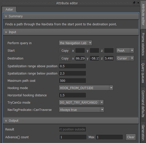

  4. Open the Query Browser panel on the left side of the main Navigation Lab window, and select the Astar query.
  5. Open the Attribute Editor panel on the right side of the main Navigation Lab window. Here, you can set the parameters for the selected query.
    Set the Start and Dest controls to PosA and PosB respectively. This tells the query that you want to compute a path from the position A marker to the position B marker.

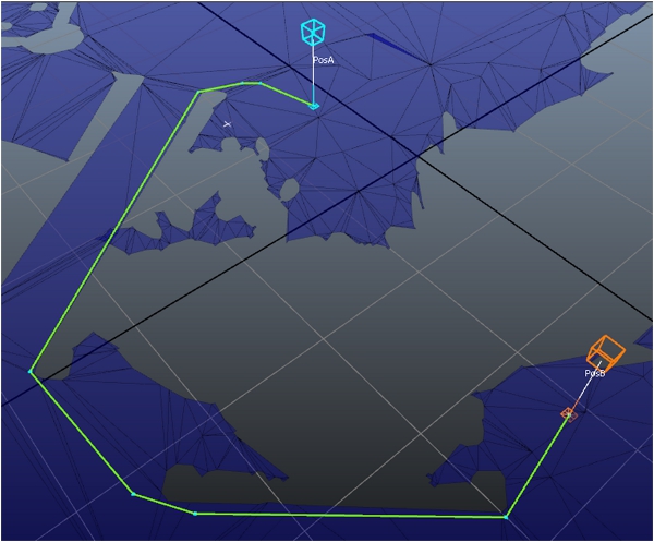

  6. If there is a path between these positions, it will be drawn in green in the 3D view:
Note that you can easily retrieve the start and end points for the query from the Navigation Lab. At the bottom of the main window, the Navigation Lab lists the positions of the A and B markers in 3D space (expressed in the Navigation coordinate system). Click the Copy buttons to copy these values to the clipboard.

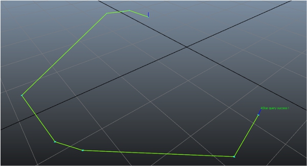

Back in the Navigation Lab
When you connect to your game, you should now see the path computed by the query drawn in the 3D view. Assuming that your NavMesh is the same, and you are using the same positions for your A and B markers, the resulting path should be the same as the one shown when you ran the query for the first time inside the Navigation Lab:
