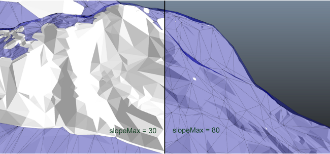

You should only need to use multiple Databases if you have multiple different types of characters that have either:
In cases like these, the differences in the areas of the terrain that are navigable to the two types of characters are different enough that two sets of NavData are warranted, which implies the use of two Databases to manage the different sets of NavData in the game at runtime.

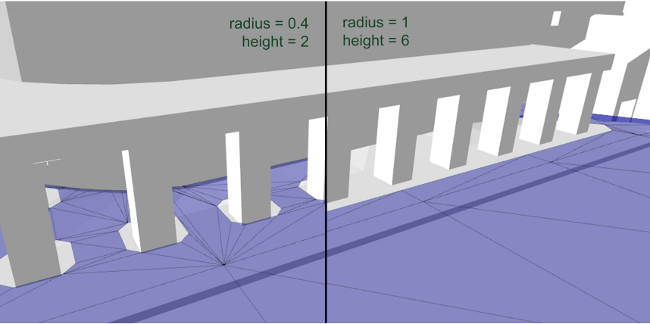

Typically, the static NavData that you pre-generate for your terrain is the largest consumer of runtime memory when using Gameware Navigation. Therefore, to avoid unnecessary duplication, you will probably want to make your characters share the same NavData whenever they can: i.e. whenever the differences between the characters are small enough that they do not cause noticeably strange behavior at runtime.
If you choose to share a single Database for multiple different types of characters, it is safest to generate the data using the radius and height of the largest character. This is readily apparent if you consider the case of the human and the giant:
  • If you generate data using the dimensions of the human, the border of the NavMesh will be at a distance from the static geometry roughly equal to the human's radius. At runtime, the giant may therefore plan paths that pass closer to the static geometry than its own radius, which can lead to collisions.
  • If you generate data using the dimensions of the giant, the border of the NavMesh will be at a distance from the static geometry roughly equal to the giant's radius, which is safe for both characters to use in their path finding and path following. However, it may lead to the smaller characters being unable to access some areas of the terrain that they should normally be able to reach, like the narrow corridor shown above, small hiding places, etc.
In cases like this, there is a tradeoff between on one hand conserving runtime memory by sharing NavData, and on the other hand increasing path finding and path following realism by tailoring each character's NavData to their precise dimensions. Ultimately it is up to you to decide which you should prioritize in your game.
