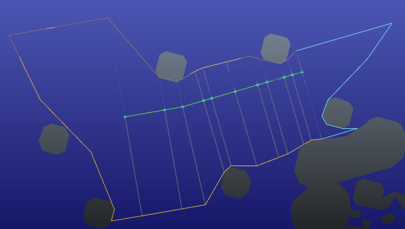

Channels are arrays of gates. The quad or triangle between two adjacent gates is called a channel section. Each section is completely free of any NavMesh obstacle. See the following figure:

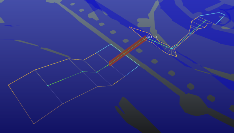

A path that goes through a NavGraph is associated with several channels. If enough space (width) is not available around the path to have a valid channel, the channel is split on the NavMesh. So, each NavMesh-laid part of the path can have more than one channel. All these channels are gathered into a ChannelArray that is aggregated into the path. See the following figure:

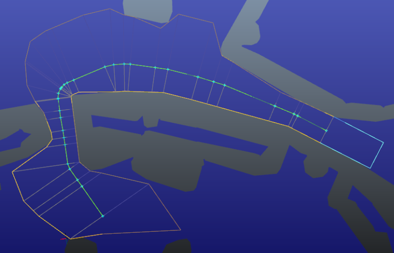

You can create channels within path finding queries. When you use the functions in Kaim::Bot such as, Kaim::Bot::ComputeNewPathToDestination or Kaim::Bot::InitAStarQueryForBot to launch path finding queries, channels are automatically computed if the bot trajectory mode is Kaim::TrajectoryMode_Spline. If you initialize and launch path finding queries, you can enable channel computation using the SetComputeChannelMode function. The query enters ChannelArray computation stages that build a new channel around each refined path portion on a NavMesh. The original path is then replaced with the aggregation of channels and NavGraph-based original path portions that are left unchanged.
Channels are computed by gathering the free space around the original refined path. After the available free space is found, a radius-adaptive string pulling finds the mandatory turns considering the maximum free space in these corners. This determines the turn gates of the channel. Intermediary gates are then added when there is a long distance between turns to enlarge the available space wherever possible, which is used to find wider turns in the trajectory.

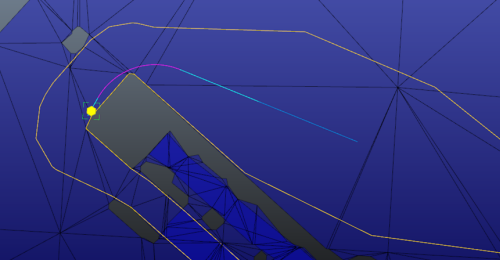

The SDK comes with a SplineTrajectory component that maintains and follows a circle-arc-based spline fitting the channel. This CircleArcSpline consists of circle arcs (magenta) and segments (cyan). See the following figure:
The spline is optimized to let a preferred distance to corners on each side and to lie on circles of preferred radii. However, when the channel is too constrained, these are released and the spline is left unchanged (sub-optimal) at these places.
The spline is recomputed if it is in the degraded mode (SplineComputation_Degraded). If the spline is not recomputed, the tail of the current spline is not modified over a given distance (5m, by default) when updating the channel trajectory. This provides a frame to frame stable trajectory that anticipates the upcoming turns. You get precise and stable information with SplineTrajectory to feed the animation system for an animation driven locomotion of your bots.

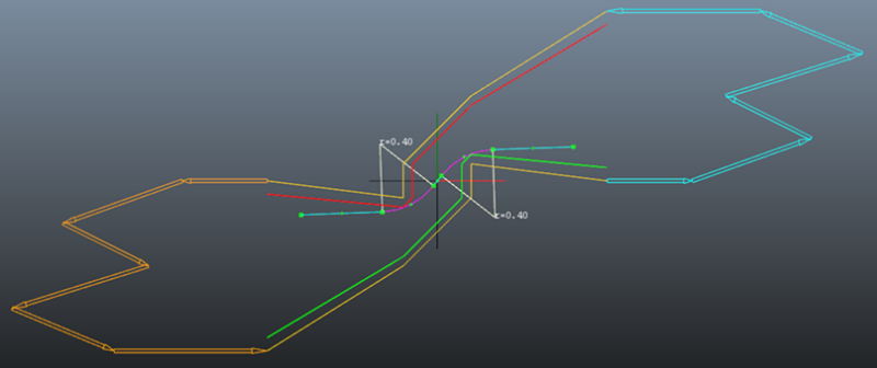

You can define the minimal distance of a spline from the inner corners of a turn in a narrow channel using the DistanceToInnerCorner() function.

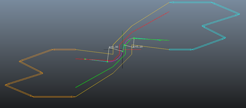

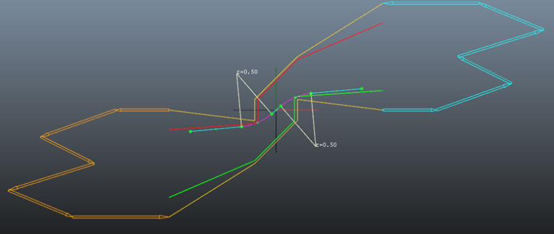

Previously, a float parameter (distToBorder) was used for computing the distance from the borders. When channelWidth was too small (less than two times of distToBorder), this distance was relaxed so that the spline passes about midway through a narrow channel. Now, you can customize this relaxation by defining a piecewise continuous affine function that gives the distance between the spline and the corners in the inner side of turns as a function of channelWidth. This function representation is a polyline that starts at (0,0), passes through several points, and becomes constant after the last point. It is parameterized by providing the polyline points [p0 to pn]. The (0,0) point is not provided because the first segment is automatically taken from (0,0) to p0. The default value has just one point (0.4, 0.2) that acts like the single float distToBorder parameter with the default value of 0.2. It is linear with linear coefficient of 0.5 when channelWidth is [0, 0.4], and constant to 0.2m when channelWidth is greater than 0.4m.
Typically, it is used for defining low linear coefficient (for example, y=x/10) sections for small channelWidth values and then rejoin y=x/2 somewhere at a maximal distance. See the following figures:
The red and green polylines are obtained by offsetting the channel borders with the corresponding distance to the inner corners.
