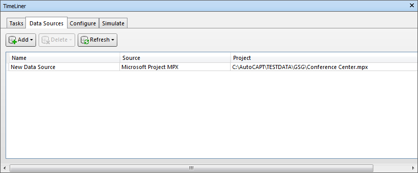

Data Sources Tab
The Data Sources tab enables you to import tasks from a third-party scheduling software, such as Microsoft Project, Asta, and Primavera. It shows all added data sources, listed in a table format.
The Data Source View
The data sources are shown in a multi-column table. The columns show name, source (for example, Microsoft Project™) and project (e.g. my_schedule.mpp). Any further columns (there may be none) identify the fields from the external schedule which specify the task type, unique id, start date and end date for each imported task.
You can move and resize columns, if necessary.
The Data Source Buttons
Add
Creates a new connection to an external project file. Clicking this button displays a menu listing all project sources that may be connected to on the current machine. See Supported Scheduling Software for more information on which sources are available.
Delete
Deletes the currently selected data source. If you have refreshed the data source before you deleted it, any tasks and data read from the data source will remain on the Tasks tab.
Refresh
Displays the Refresh from Data Source Dialog Box where you can refresh the selected data sources.
