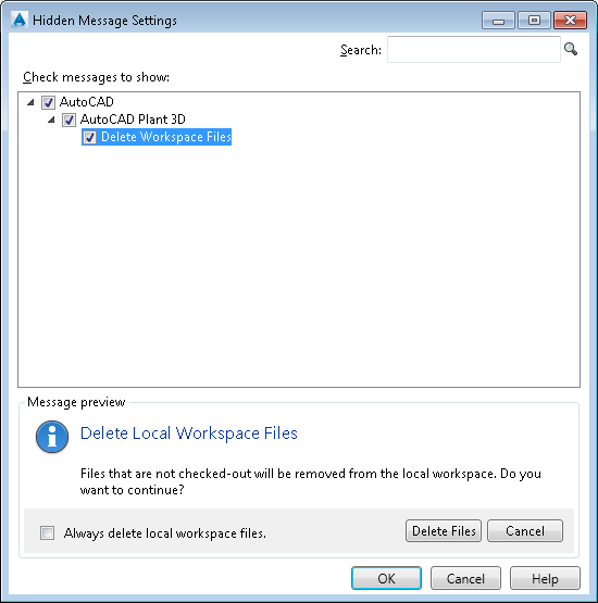

Most vault status and warning dialogs now have a [x] Do Not Show option.
You can enable previously hidden messages using the options command in the System tab.
