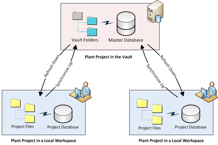

When you first open a plant project from the vault using the Project Manager, a local workspace is created and files are copied from the vault. Additional users create a separate local workspace.
The project database in the local workspace is updated () as you save files in the working folder. The project master database is updated when you check in files to the vault.

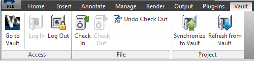

Vault Ribbon
You can manage your vault log-in session and vault project files from the ribbon.
Go to Vault in the ribbon loads Autodesk Vault Client (vault explorer). The Autodesk Vault Client login session is not the same as the AutoCAD Plant 3D session.
Important: Do not use Autodesk Vault Client to work with plant projects. Except for certain administrative tasks, use the Project Manager to manage plant projects in the vault.
For more information on the ribbon commands, see the Vault Command Reference.

After your project administrator provides you with a vault server location and credentials, you can use the Project Manager to open a project. The first time you open a vault project you specify the location of your working folder. Project files are then copied to your working folder from the vault.
Project files are initially read-only in your workspace folder. The Project Manager prompts you to check out files as you work. You can check in project files when your changes are complete. You can also synchronize to vault to share your work-in-progress without checking in the files.
