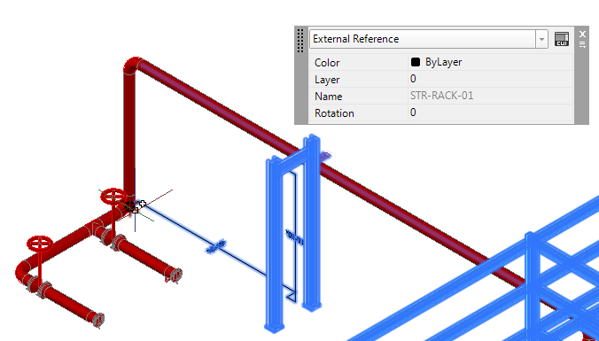

For example, you can reference a structure such as a beam. An Iso reference dimension is placed in the 3D model and displays a preview of the reference dimension that will be added to the Iso drawing. Select or highlight the Iso reference dimension to display the preview.
In the isometric drawing, dimensions to the referenced object are created. You can also specify the reference linetype and accompanying text.

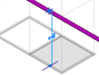

When not selected or highlighted the Iso reference dimension is hidden inside piping. It is similar to an Iso Message, but Iso reference dimensions have coordinate lines that extend a small amount outside piping.
Wireframe view.
The lines allow you to select the Iso reference dimension in non-wireframe views.
Visible in transparent piping.
Both Iso messages and Iso reference dimensions are created on the Iso Information layer.

Iso reference dimensions can reference plant objects, non-plant objects (AutoCAD line), or even no object (a location in space).
If a plant object is referenced, the initial settings of the Iso reference dimension are set intelligently. Plant objects in an xref are referenced intelligently.
Reference to structure in an xref.

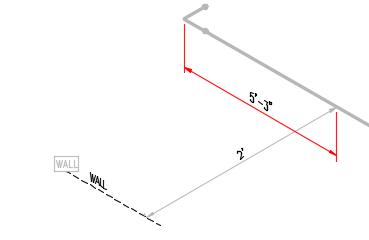

You can specify a skew dimension type that creates one dimension for the total distance.
Skew dimension.
You can also create a locating dimension along piping to the Iso reference dimension location.
Locating dimension.
