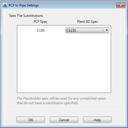

PCF to Pipe Settings dialog box
Sets up spec file mapping for PCF imports.
PCF Spec
The PIPING-SPEC specified in the PCF file.
Plant 3D Spec
The project spec (SPX) file to map to for the PCF spec.
Note: The placeholder spec is used for any PCF specs not listed here.
