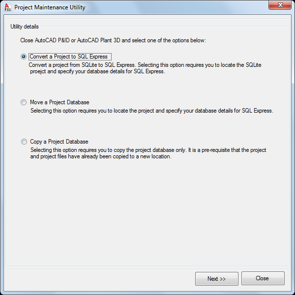

Converts, copies, or moves a project to SQL Server.
Command entry: PnPProjectMaintenance.exe in the program folderYou can convert a project from the default database (SQLite) to SQL Server. You can also copy or move a SQL Server database to a different database name or server.
A back up of the SQLite files (*.dcf.bak) is created in the project directory. You can rename the files, by removing the .bak, to revert back to the default (SQLite) format. This must be done before making any modifications to project drawings.
