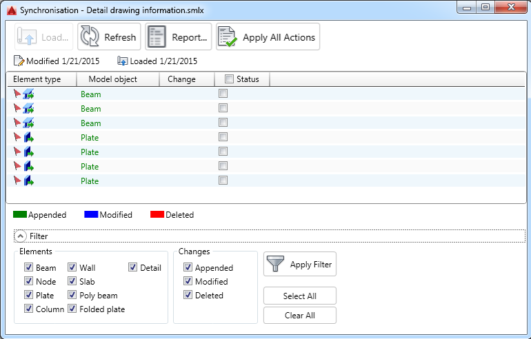

Main tick boxes with applied filters
In the Synchronization dialog the Main tick boxes work with applied filters. If objects are selected using the filters and a main tick box is activated, only those lines will have the individual tick box selected.
Sync dialog - Main tick boxes Sync dialog - Selection filters
In the following images there is an example:
Column elements were selected to be displayed (). Status main tick box was selected (). All objects were made visible again ().
In the dialog you will see that only the Column lines have the individual tick boxes selected.

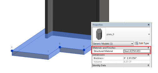

  • Material
In the following example the base plate material was modified to "Steel ASTM A53" in Advance Steel. This modification was then synchronized in the Revit project. The difference is spotted as a Material change. If the modification is applied, the plate material is changed according to the new value.
