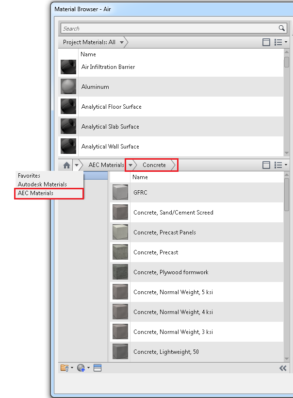

Common structural materials from the Revit metal and concrete categories are mapped to Advance Steel for use during import.
Common structural materials from the Revit Metal and Concrete categories are mapped. These materials can be found in the AEC Material library in Revit.
