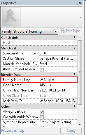

These families contain 2 newly created parameters:
Family Name Key
Section Name Key
The Family Name key parameter is mapped 1 to 1 to the Table Name from Advance Steel. This parameter is stored in the family.
