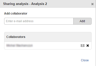

To share an analysis:
- On the Projects tab, select a project.
- On the project page, select a model.
- Locate the row that contains the analysis to share, and click the
Sharing icon.
- In the Sharing analysis dialog, enter the e-mail address that the collaborator uses to log in to the Autodesk account, and click Add.
It must be the e-mail address used in credentials of an already existing Autodesk account. The added collaborator displays on the list under Collaborators.
- Click
to send the collaborator an invitation e-mail containing the link to the selected analysis.
- Add another collaborator, or close the Sharing analysis dialog.

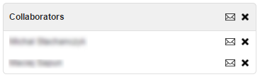

If you added several collaborators to the list, you can click
in the Collaborators row to send invitation e-mails to all of them.
To remove collaborators from the sharing list:
- To remove a collaborator, click
in the row containing the collaborator's name.
- To remove all collaborators, click
in the Collaborators row.
