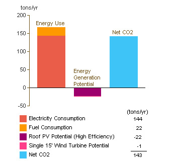

When reviewing an energy analysis in the Results and Compare dialog, this graph summarizes the estimated CO2 emissions associated with energy consumption for the analyzed model.
The graph illustrates the following equation:
Energy Use CO2 — Energy Generation Potential CO2 = Net CO2

| Energy Use | The estimated annual CO2 emissions for electricity and fuel consumption for the analyzed model. |
| Energy Generation Potential | A negative number representing tons of carbon you can potentially remove from the project by using renewable energy rather than obtaining power from the electricity grid. This value includes on-site renewable potential from the Roof PV Potential (solar electric) and the Wind Turbine Potential (one turbine) for the project, based on its climate and geometry. |
| Net CO2 | Total CO2 emissions from the project's energy consumption, minus the Energy Generation Potential. |
