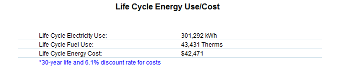

Life Cycle Energy Use/Cost
When reviewing an energy analysis in the Results and Compare dialog, this table summarizes the estimated energy usage and cost over the life of the building, assuming a 30-year life span.
Note: Available as an Autodesk® Subscription Benefit.
Parameter Description
Life Cycle Electricity Use An estimate of how much electricity the analyzed model may use during a 30-year-period.
Life Cycle Fuel Use An estimate of how much fuel the analyzed model may use during a 30-year-period.
Life Cycle Energy Cost An estimate of how much fuel the analyzed model may use during a 30-year-period.
