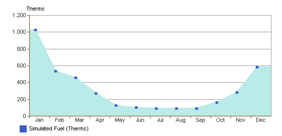

When reviewing an energy analysis in the Results and Compare dialog, this chart displays the project's estimated fuel usage by month.
If the project uses fuel for heating (as opposed to electric heating sources), fuel usage increases during the colder months of the year.
