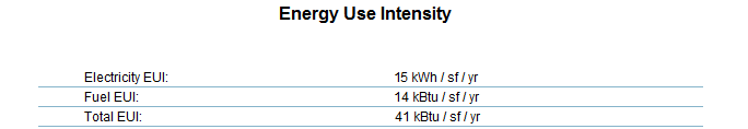

When reviewing an energy analysis in the Results and Compare dialog, this table provides information about energy use per unit floor area.
Because Energy Use Intensity (EUI) is a per-area metric, it is a convenient method of comparing project energy consumption when analyzed buildings have different sizes.
| Parameter | Description |
| Electricity EUI | A measure of the annual electricity usage per floor area. |
| Fuel EUI | A measure of the annual fuel usage per floor area. |
| Total EUI | A measure of the combined electricity and fuel used by the project, per floor area per year. For this metric, the electricity usage is converted as follows:
