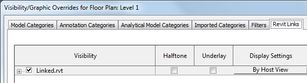

- Open the view in the host model.
- Click View tab
Graphics panel
(Visibility/Graphics).
- On the Visibility/Graphic Overrides dialog, do the following, as desired:
- Specify overrides for model categories, annotation categories, and imported categories in the view.
- Add a filter to apply to the host view.
- On the Revit Links tab, for the linked model, do the following:
- In the Visibility column, select the check box.
- In the Display Settings column, make sure that By Host View displays.
If By Host View does not display, click in the Display Settings column. On the Basics tab of the RVT Link Display Settings dialog, select By host view, and click OK.
- Click OK.
The specified view filter applies to the host model, the selected linked model, and its nested linked models (that is, any models that are linked to the linked model).
