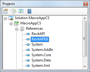

| Do I need to add RevitAPI.dll and RevitAPIUI.dll as references when writing a new macro? | No. You do not need to reference RevitAPI.dll and RevitAPIUI files because this step was completed for you. A Revit macro project uses both as required references. Revit macros will fail if you delete these references in the IDE: ![]() |
