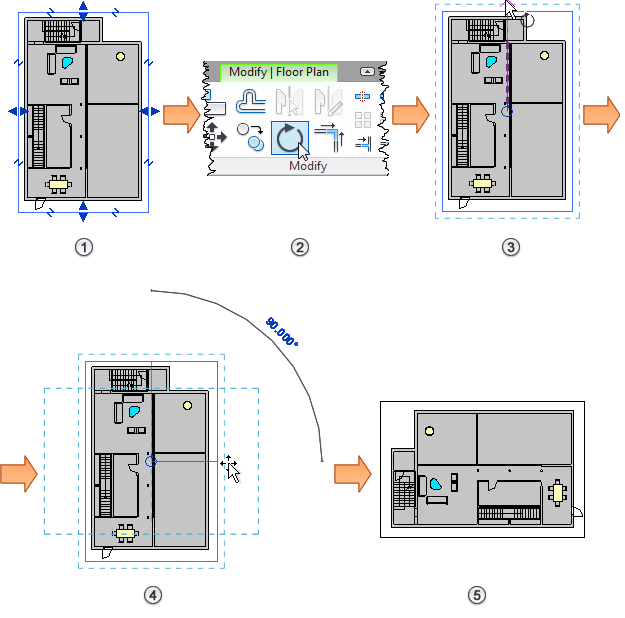

When you rotate a view using the crop region, the model rotates in the opposite direction of the crop region.
- On the View Control Bar, click
(Show Crop Region). Select the crop region. The crop region displays in the view. You may need to zoom out to see it.
- Click Modify <view type> tab
Modify panel
(Rotate). Note: If the Rotate tool is not available, in the Properties palette for the view, set Orientation to Project North.
- Rotate the view.
