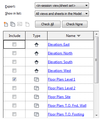

When exporting a model to various formats, use tools on the Export dialog to select the views and sheets to include. Save the selected set for later re-use.
To create or modify view/sheet sets, first open the related Export dialog: click ![]()
Export
CAD Formats, and select the desired format for export. Use the following tools in the Export dialog.
The model-based filters list views and sheets from the project, disregarding the chosen set. View and sheets are listed in alphabetical order.
(New Set). Creates an empty set.
