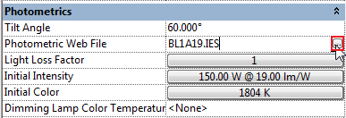

    3. In the list of parameters, scroll down to Photometrics.
    4. For Photometric Web File, click in the Value column.
    5. Click (Browse).
      Note: The Browse button displays after you click in the field.
    6. Navigate to the desired IES file, select it, and click Open.
    7. Click OK.
    8. Save changes to the project or the lighting fixture family.
