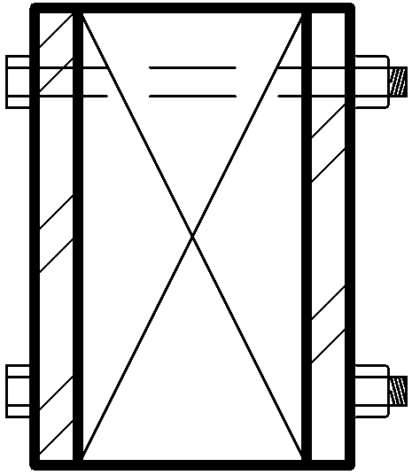

The following example illustrates the results after selecting View tabGraphics panel (Remove Hidden Lines), and then selecting the 4x6 stud and the bolt. This procedure removes the hidden lines, and the 4x6 stud completely obscures the bolt.
Architectural example
Structural example
