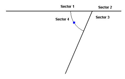

Tip: You can select multiple reference points for the dimension. Each element you are dimensioning must pass through a common point. For example, to create a multiple-reference angular dimension among 4 walls, each of the 4 walls must pass through a common point.
- Drag the cursor to size the angular dimension. Select the sector where you want the dimension to display:
Wall join with 4 distinct sectors
- When the dimension is sized properly, click to place it.
