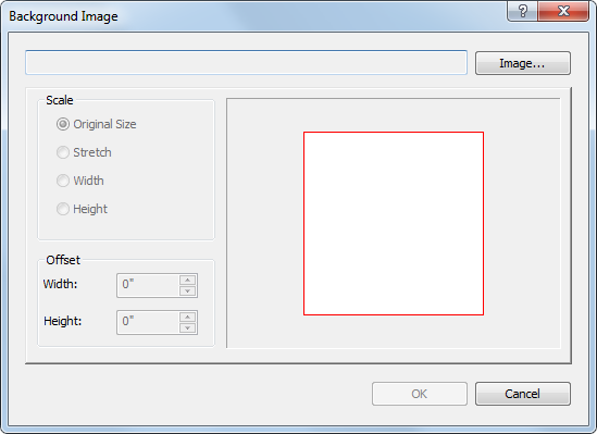

To specify a custom image
- In the Rendering dialog, under Background, for Style, select Image.
- Click Customize Image.
- In the Background Image dialog, click Image.
- Navigate to the location where the image file resides, select the image, and click Open.
- In the Background Image dialog, specify Scale and Offset, and click OK.
- Continue to define other render settings.
