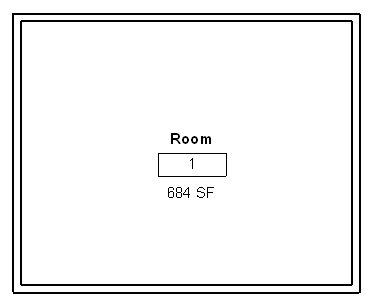

For example, suppose the main model contains the following room.

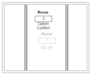

When a room is added to a design option, the room tag reports an option conflict.
To learn the cause of the option conflict, select the room tag in the plan view, or, in a room schedule, select a cell in a row that shows a conflict. Then click Modify | Room Tags tab
Warning panel
(Show Related Warnings). A warning dialog displays, which you can expand to read about the conflict and learn possible remedies for it.
Solution: In general, to correct room option conflicts, add the conflicting main model room to the design option set. This removes the room from the main model and resolves the conflict.
