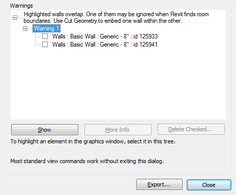

You can display a list of warnings related to an element.
Warnings panel
(Show Related Warnings).
The list of warnings displays in a tree view.
Expand items to see the individual elements associated with each warning. When you select the text next to a warning, the element highlights in all open views where it is visible.
To delete an element from the model, select the check box next to an element name, and click Delete Checked.
