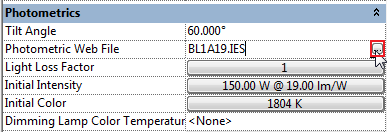

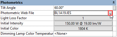

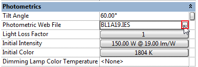

    3. In the list of parameters, scroll down to Photometrics.
    4. For Photometric Web File, click in the Value column.
    5. Click (Browse).
      Note: The Browse button displays after you click in the field.
    6. Navigate to the desired IES file, select it, and click Open.
    7. Click OK.
