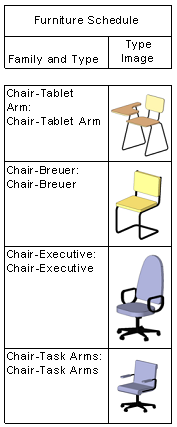

Create a Furniture Schedule with Images
This example illustrates how to include images in a furniture schedule, but you can use the same procedure to include images in other types of schedules.

  8. Create a Furniture schedule, and include the Family and Type, and Type Image fields.
  9. Create a sheet view and place the furniture schedule on the sheet. The furniture images display in the schedule viewport placed on the sheet.
