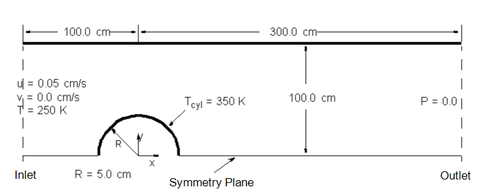

A circular cylinder with an infinitely long axis (thus approximated as 2D) is immersed in a laminar flow with a Reynolds number of 50 (based on the diameter of the cylinder). The cylinder wall has a fixed temperature 100 K higher than the fluid bulk temperature. This model is analyzed to verify the fluid flow and heat transfer modeling capabilities of Autodesk® CFD.

Geometry and Boundary Conditions
