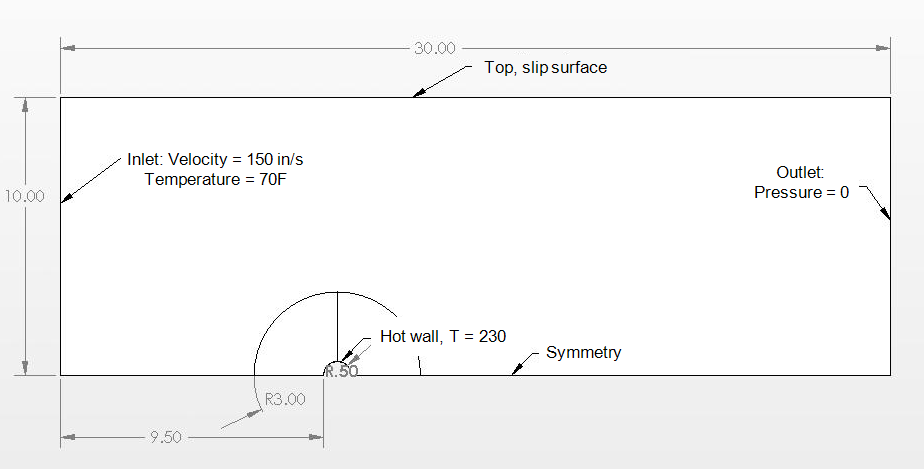

Geometry and Boundary Conditions
All dimensions are in inches:
