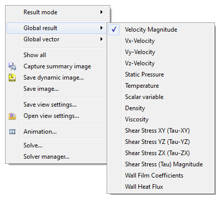

Note: When the Global Results mode is active, results entities cannot be modified. However, in any Results task, to control the display of results on the entire model, right click on or off of the model and make the appropriate selections from the Global result and Global vector controls:

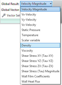

The Global Result
To specify the result quantity displayed on model surfaces, right click, and select Global result:
Alternatively, select from the Global Result menu on the Global context panel:

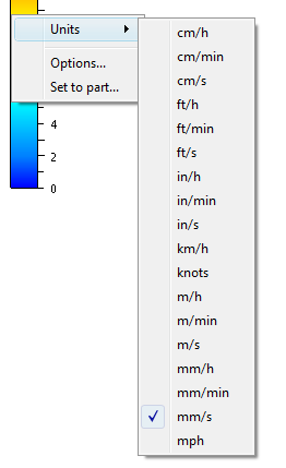

To change the units:

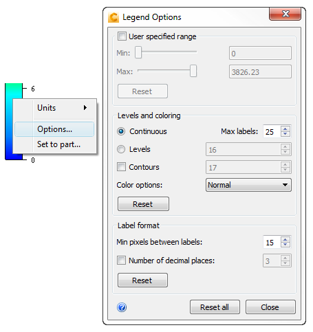

To change the appearance, range, and settings:
To change displayed units
Right-click on the legend, and select Units.
To modify legend appearance
Right click on the legend, and click Options.
To change the range
  1. Check User specified range.
  2. Adjust the range with the Min and Max sliders.
Note: To increase the range, key in a value in the field adjacent to the appropriate slider.
