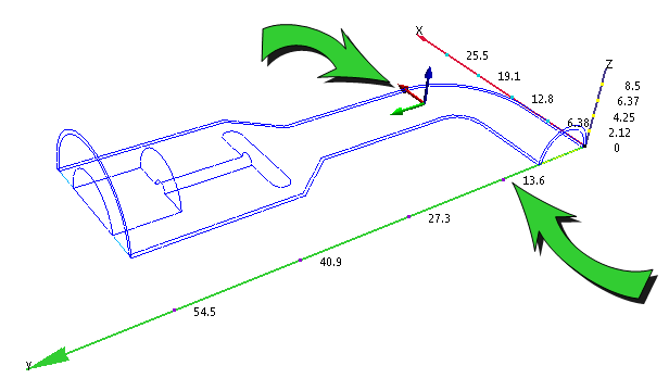

Click Axes to toggle the display of the model coordinate axis and the axis bounding box.
The value in the adjacent field is the number of axis increments. Change this number with the arrows to the right of the field.
