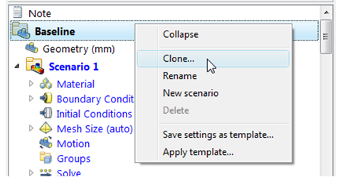

1. Right click on the Baseline design in the Design Study Bar and select Clone…
2. Enter the name “Floor Registers Active” to the cloned design. Click OK.

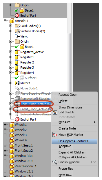

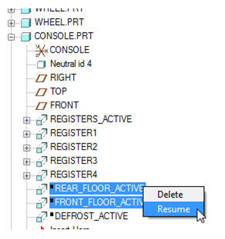

3. In the CAD model, enable the features that allow air to flow to the front floor and the rear floor registers. In the console part, activate the following features:
Autodesk® Inventor
PTC Creo or Pro/Engineer
UG NX
Make console part (or console-r part) the working part and activate the part navigator. Check the box to enable each feature.
SolidWorks
Note: The objective of this design change is to eliminate the higher floor temperatures. We hope to do this by adding registers to provide cold air to the front and rear floor regions.

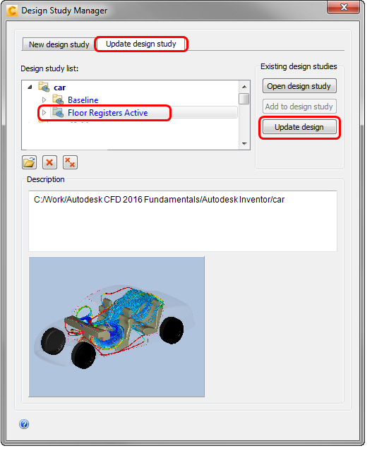

4. Launch Autodesk® CFD and update the cloned design with the new CAD geometry:
To launch from CAD...
  1. In the Design Study Manager, click the Update design study tab.
  2. Expand the car design study.
  3. Select the Floor Registers Active design.
  4. Click Update Design.

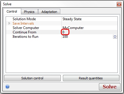

6. Right click off the model and choose Solve…
7. Set Continue From to 0 and click Solve.
8. When prompted if you want to delete all results after iteration 0 and continue, click Yes.
