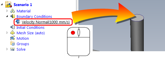

To define and then apply a boundary condition
An alternative workflow is to create a boundary condition before applying it to the model.
- Click Edit on the Boundary Conditions context panel. Alternatively, right click on the Boundary Conditions branch of the Design Study bar, and click New BC....
- Define the boundary condition in the Boundary Conditions quick edit dialog, and click Apply.
- Drag the unassigned setting from the Design Study bar onto the model entity:
Note: To assign a setting that is currently assigned to another object, drag it from the Design Study bar onto the model entity.
