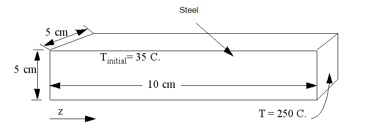

For this case, transient heat transfer in a 3-D steel block is modeled. We apply insulated boundary conditions on 2 dimensions so that the analytical expression for transient conduction in a semi-infinite solid can be used.
Geometry and Boundary Conditions

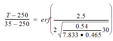

An analytic solution can be obtained by employing the Laplace transform technique. From the Holman reference, the analytical solution for transient conduction in a semi-infinite slab is:
From the properties in the above table and using 35 C as the initial temperature and 250 C as the boundary temperature, the temperature 2.5 cm from the boundary at t = 30 seconds is calculated:
The calculated temperature is 121.42 C.
