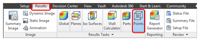

3. Select Points from the Results tab:

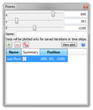

4. Specify the coordinates of the desired results point as: 600,161,-2100. Name the point “rear floor”. Click the "+" icon to create the result point. Check the Summary box to make the point available for comparison across other designs.
Note: Specify the coordinates either by keying them in or with the sliders.

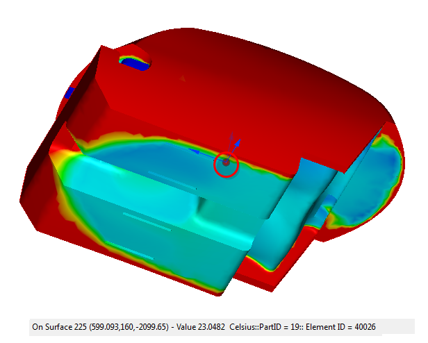

5. Probe near the results point and note the temperature:
