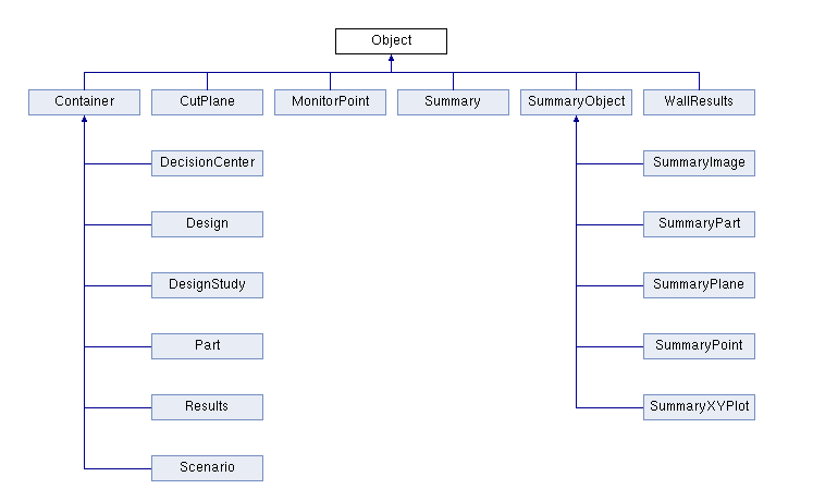

Class Structure
The API class structure has a specific hierarchy. Object is the top-level class, and has several classes below it. The Container and SummaryObject classes have child classes of their own. The complete class structure is shown:
To call a specific static function, use the following structure:
Module.class.function
For example, to define a variable called study as the current design study, use this command:
study = Setup.DesignStudy.Create()
This calls the Create function, which is in the DesignStudy class, which is in the Setup module.
Note: The Object class (which is owned by the Setup module) contains classes with entities that belong to the other modules as well. Keep in mind that classes and objects are different things. The CutPlane class is shown in the hierarchy under the Object class, which allows it to inherit all of the members of the Object class. However, in this sense, a cutplane is an abstraction, and refers to a type of entity. When a cut plane is created in a model, it is real object, and not an abstraction. Therefore, it is part of the Results module.
