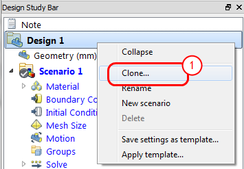

- In Autodesk® CFD, on the Design Study bar, right click on a Design, and click Clone. Assign a unique name to the new Design. Note that all scenarios of the Design are also cloned.
