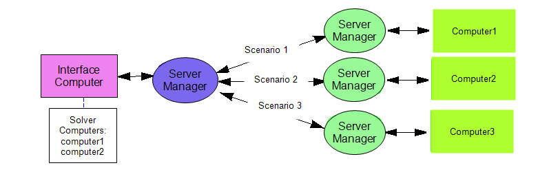

Interface Computer
The simulation is defined on the interface computer. The CAD model is usually prepared here as well.
Solver Computer
The simulation is run on the solver computer. Use the Solver Computers dialog (Setup > Simulation drop down menu > Solver Computers) to designate computers on the network as remote solver computers.
Server Manager
CFDServerManager.exe is a service that must be running on each Solver computer. This service waits for a call from an interface computer to start an analysis. When a call is received, it provides communication between the two computers.
This service is configured to start automatically on the Interface and Solver computers when the software is installed. It can be stopped, started, and monitored using CFDServerManager.exe, located in the installation directory.
If an error occurs on the Interface computer indicating a refused connection, check that this service is running on the Solver computer.

Launch the model from the CAD system to the Interface computer, and set up the simulation as you would a model to be run locally. When ready to run, open the Solve dialog, and select the desired computer from the Solver Computer menu on the Control tab. Click Solve to launch the simulation.
Instead of running on the local computer, the simulation data is sent to the specified Solver Computer. The mesh is generated and the results are calculated. As the scenario runs, graphical results are sent back to the Interface computer for run-time results visualization.
