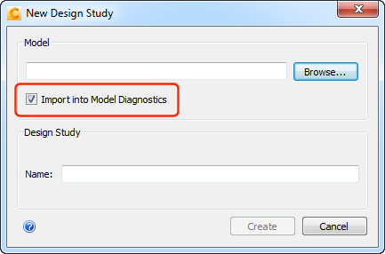

You can also activate the MAT when you import geometry directly into CFD without the use of a CAD application. The New Design Study dialog has the option to Import into Model Diagnostics, as shown in the following image. If this check box is selected, your model opens into the MAT when you click Create.
