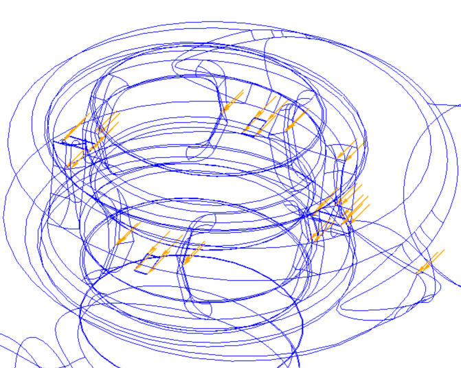

When the model is first opened, all edges that are three orders of magnitude or more smaller than the largest edge in the model are identified, and the slider can be used to vary the highlighted size.
A default Minimum Refinement Length is automatically determined based on relative edge lengths throughout the model. This value is shown in the Min Refinement Length field in the dialog, and is the default slider position. When the slider is at this position, all highlighted edges fall below this value, and will only be meshed with two nodes.
If a large number of edges are smaller than the Minimum Refinement Length, it may be necessary to reduce its value. In such cases, the Mesh task dialog will open directly to the Edge Diagnostic panel, and many edges will be marked with arrows. Reducing the Minimum Refinement Length will improve the chances of successfully generating a mesh.
Edges that are the current size indicated by the slider and smaller are highlighted.

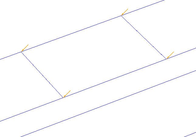

As an example, the model shown has four very small edges at the corners of the cut-out. Each edge is highlighted, and is identified with an arrow:

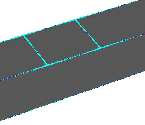

In the following image, the Minimum Refinement Length is set to be smaller than the length of the four small edges. Note their effect on the mesh:
Edges that are longer than the default Minimum Refinement Length are meshed finer, and affect neighboring geometry.

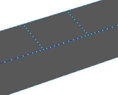

In the image below, the Minimum Refinement Length is set to be larger than the small edges. The mesh distribution will be considerably more coarse. The edges will be meshed, but will not strongly affect the mesh on surrounding geometry:

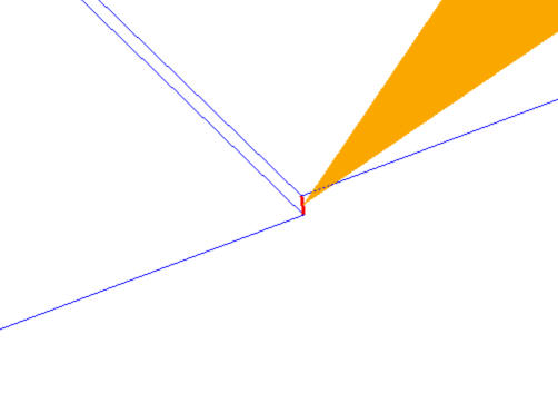

Surface mode Diagnostics identifies potentially problematic surfaces that may lead to meshing difficulties. Examples of such surfaces include slivers (left), very thin annular surfaces (middle), and surfaces with a “cusp” or tangency region (right):
Surfaces are deemed “problematic” based on the separation distance between edges. The variation of separation distances is assessed to determine a minimum threshold. All surfaces with an edge separation distance below this threshold are considered potentially problematic, and are shaded.
Extremely high-aspect ratio surfaces such as slivers and annuli have edges that are very close to each other within the separation distance. Surfaces that contain tangencies may be mostly well formed, but can be considered problematic because of the tangency between two or more edges.
