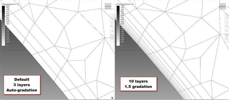

Layer gradation
Use Layer gradation to control the rate of growth of the enhancement layers. As the number of enhancement layers increases, the layer thickness often has a tendency to become uniform. Gradation allows the layers nearest the wall to be smaller than those closest to the neighboring unstructured elements.
Use this setting to improve the accuracy of heat flux at the wall as well as for the SST k-omega turbulence model.
When the Number of layers is greater than 5, you should change the Layer gradation value from Auto to a value. This is an effective way to reduce the element thickness near the wall and the value of Turbulence y+. When simulating external aerodynamics with the SST k-omega turbulence model, a low value of y+ is essential for accurate flow prediction.
You can also change the value with the mesh_enhance_gradation in the Flag Manager.
