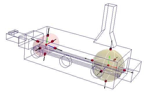

Select the shape (box, cylinder or sphere) from the Region Type line.
There are two ways to define size, position, and orientation: graphically or by keying in values. A good technique is to use the graphical tools first and then "fine tune" by keying-in values.

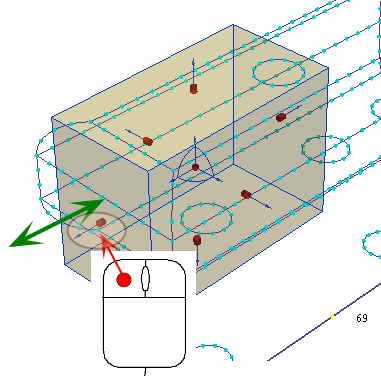

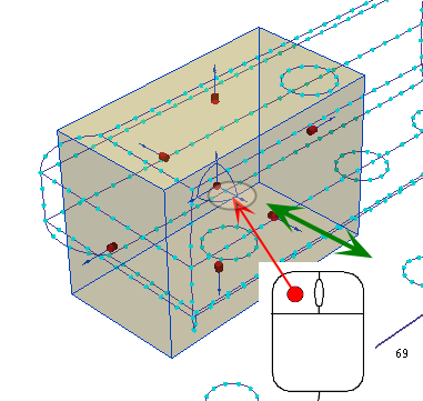

Use the Grab handles and a Coordinate Triad to positioning the region.
To resize a region:
To move or rotate a region:

"Step 2" of the Mesh Refinement Regions dialog includes a table to define the shape, position, size, and orientation of the active region.
To define the shape
To define the position and size
To define the orientation

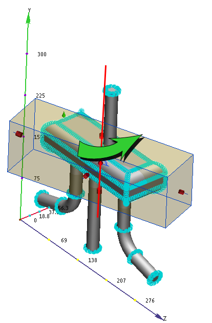

You can use the angle commands to rotate the region:
Multiple rotations occur relative to the local axes of the region, not the global coordinate axes.
Step 1: +Y Angle = 20 degrees
Starting from the default position, the region rotates 20 degrees about the global Y-axis.

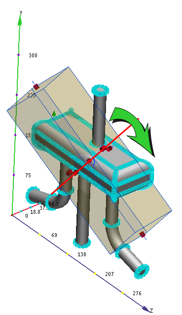

Step 2: +X Angle = 45 degrees
When we change the +X Angle to 45 degrees, the region rotates 45 degrees about its local X axis, and not the global X axis.
