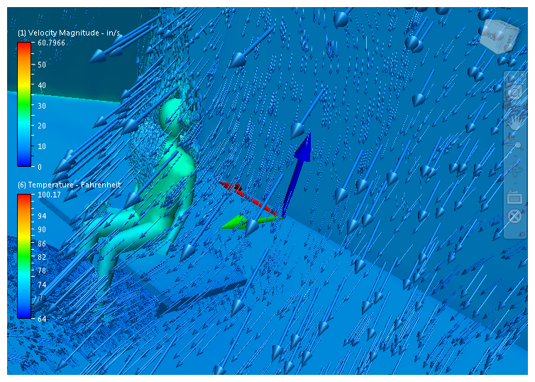

Model Walk-Through Capability
A striking way to visualize the flow inside a device, enclosure, or structure is with the walk-through capability. With this method, you view the results as if you physically inside the model.
To "enter" the model:
  1. Ensure Perspective view is active.
    • To invoke Perspective, click the menu arrow on the lower, right corner of the ViewCube, and check Perspective.
  1. Zoom into the model past the outer surfaces. You can use the mouse scroll wheel, the View tab Zoom command, the Navigation bar Zoom command, or the Zoom command on a SteeringWheel. Note that you may have to zoom in several steps before "entering" the model.
You can move around to view the internal features of the model with the pan, zoom, and orbit commands. You can also use the "Look" and "Walk" commands on the SteeringWheels.
To learn more about SteeringWheels, click here.
