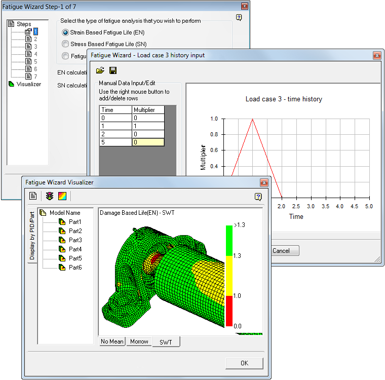

Fully Functioning (SN and EN)
Fatigue Wizard can perform sophisticated fatigue life analyses, from conventional stress-based (SN) analyses to low cycle strain-based (EN) analyses with plasticity correction. Mean stress corrections can be accounted for using standard methods. Endurance modifiers such as surface finish, temperature, and so on, are all available. For a complete list of the capabilities within the Fatigue Wizard, follow the features link.
Multiple Load Cases (Non-Proportional)
Fatigue Wizard can perform fatigue calculations using stress results from multiple load cases. Results from multiple load cases can be scaled individually using separate load histories of up to 30000 points, and analyzed as a combined load case. Alternatively, stress states from individual load cases can be used in sequence to produce the cyclic stress history.
You can scale each load case and load history individually to determine the sensitivity of fatigue life to load case.
Material Database
Successful fatigue analysis depends entirely on accurate material data. Fatigue Wizard ships with an extensive material database for stress life curves (SN) and strain life curves (EN), and component data for welded joints to BS7608. You can add to the database as data becomes available.
Fatigue Wizard also includes the capability to estimate strain life material data from readily available mechanical properties, using standard empirical relationships.
Post Processing
Fatigue Wizard includes post processing tools. An OpenGL results post processor is included within the wizard interface. You can view life contours or safety factor contours before you step back to perform 'what-if' analyses.
Fatigue Wizard also includes an automated report writer. You can create and export summary reports of the analyses you perform. This feature maximizes the time available for analysis.
