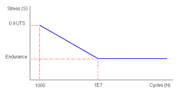

The nominal stress, SN, approach to calculating life requires minimal input to describe the material fatigue characteristics. The SN curve is generated from the material tensile strength and your input for material endurance limit.
The SN curve in the Fatigue Wizard is constructed as a straight line, on a log-log plot, from a point equating to 90% of the tensile strength at 1000 cycles, passing through the defined endurance limit at (typically) 1E7 cycles.
Life calculation is then performed as a simple linear interpolation between these points.

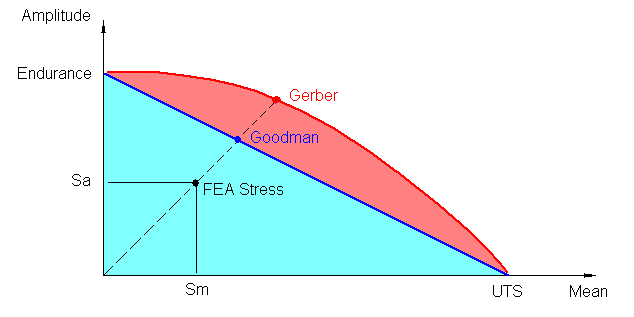

Graphical example
From FEA, for a given node, it is possible to calculate a mean stress (Sm) and an amplitude stress (SA) .
If the FEA stress falls within the
. zone (Goodman) or
. zone (Gerber) the nodal stress is acceptable.
The software performs this calculation for all nodes in the model.
